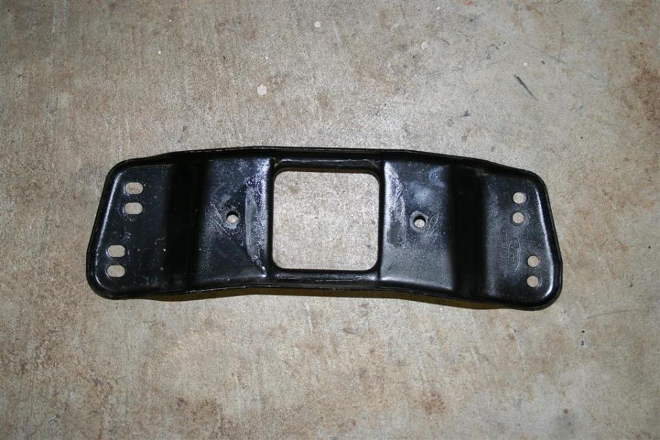

Postby Gary P. » Sat Oct 29, 2011 9:56 am
This is the mount you want. It pretty much bolts straight up.
Julies. 18.7.10 001 (Large).jpg (104.72 KiB) Viewed 5952 times
Julies. 18.7.10 002 (Large).jpg (125.63 KiB) Viewed 5952 times
