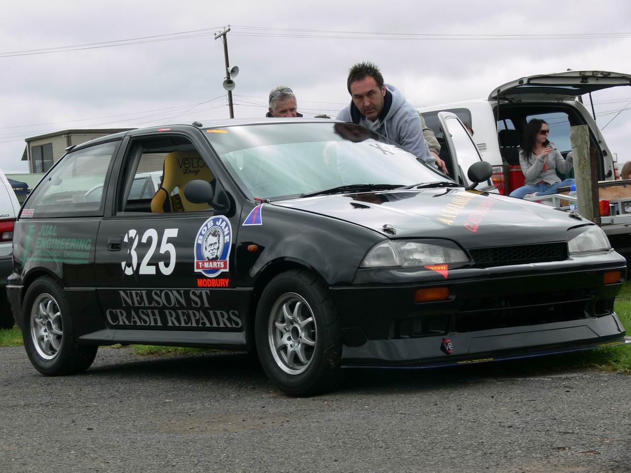

Nicely spotted by the young man...he has taste. Interestingly you also know the owner! most of the good bits on that one were from my old one and the owner was helping me out at most of the practice days. And damn him if hes not quicker than the escort.
