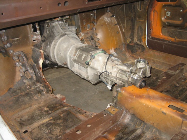

I also thought I'd slot the engine and gearbox in (Ford/Mazda BP and MX5 5 speed). They're sitting high as I just wanted to get an idea as to where everything will sit, the shifter in particular.
As you can see the shifter is a long way back, so the plan is to remove the shifter turret, cut the two forward-most mounting points off, shorten the shifter rod, move the whole lot forward so the rear mounts now bolt up to the front, then weld a new mount to the back of the turret. This should bring the shifter forward 90mm and have it come up in a similar location as a Type 9 shifter.
