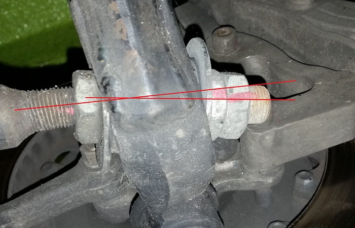

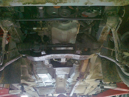

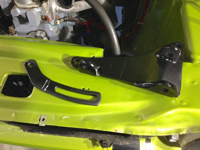

The ends of my K-Mac sway bar appear to be bent where they bolt onto the TCA. You can see this from the attached picture;
Sway Bar3.jpg (124.94 KiB) Viewed 25869 times
The steering ball joints are screwed all the way out on the steering rack ends but the adjustable TCAs are pretty much in the narrowest position. I guess the sway bar needed the mounting holes in the TCAs to be wider apart and over the few events to car has been used at the threaded ends of the sway bar just bent under pressure?!
Is this actually an issue? I assume it would be.
Is it worth trying to get the ends straightened using a torch or would this weaken the metal too much? Is a new sway bar in my future?
I have bought some steering rack extensions that will allow me to widen the track, hopefully enough to alleviate this issue. I was going to drop the suspension to put in some stiffer springs for an event next month but it looks like the current springs will need to stay in rather than open this can of worms!! PITA
I had a K-Mac bar snap at that same point many years ago resulting in a destroyed car. Chuck it in the bin now! You've done to much work on that car to damage because of a crap swaybar.
It might last another 1000km or it could break at the first corner, question is are you willing to bet your car or your health on how long it will last?
I have a K-Mac bar too and the quality is terrible. Their saving grace is that they are the only one I know of that are adjustable in situ.
Whiteline bars are better quality but use washers to adjust for caster making adjustments a PITA but if you are not the one doing the alignment then it's not a problem.
24mm. I only have 2-3 degrees of caster but have run out of thread on the sway bar! Might have to look at the anti-dive/sway bar clamp position. Did it take long for them to make a custom bar??
