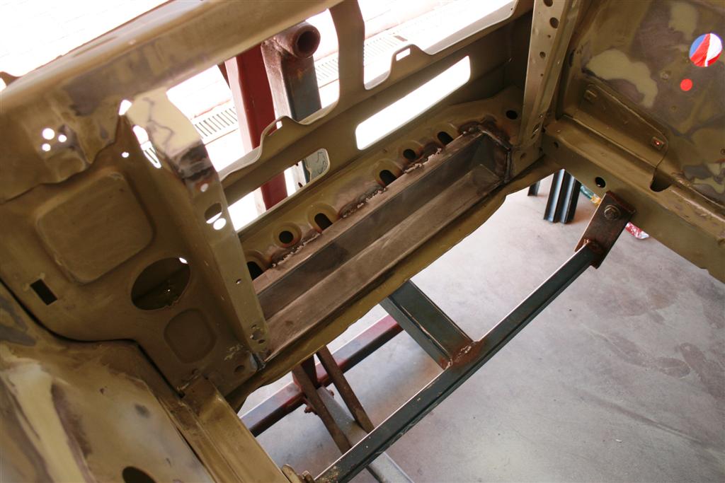

Few pics. Top 1 is lately in the garage. Others were when it was collecting dust.

Hi Steve, welcome aboard. Mk2 2.0's had this cutout for the radiator. If yours hasn't go this cutout then you will need probably need to make it.

Thanks mate. Pretty sure it doesn't. Would I be better putting a 2l Rad in? Or would the 1.6 keep it cool enough?

Get a triple core for a 2.0l radiator, use the standard shroud and engine fan and you won't have a problem. A fan on its own won't be enough, you'll need the shroud.
Edit: I'm pretty sure the pinto is longer than the 1600, and the cutout allows the radiator to move forward to fit the engine fan.
