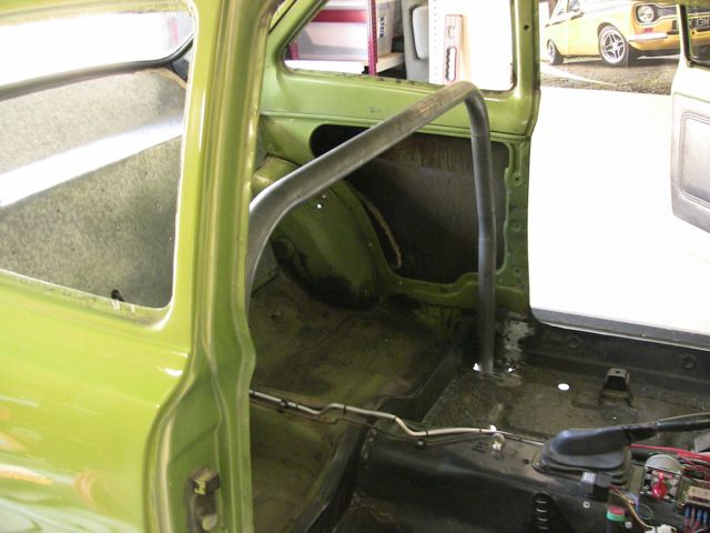

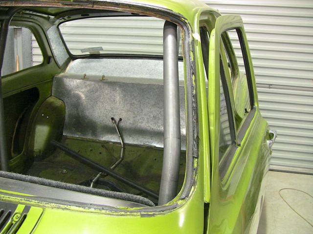

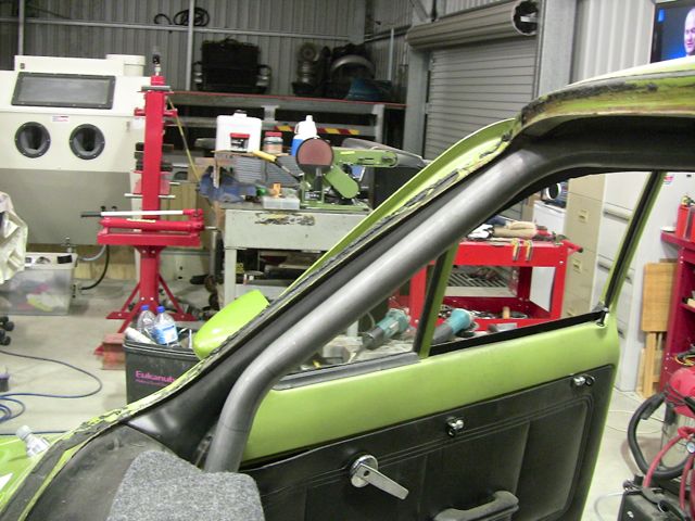

Ok, so the adventure has started. I'm having a shot at documenting this on video so i might not have to write as much here!
Started by cutting some holes in the floor to allow installation of the main hoop and measuring the overall width of it. Then made some baseplates to cover the holes, bent up the hoop and tagged it to the seatbelt bolt holes to keep it in place. Up to making the front legs next, same process as the main hoop, cut the holes in the floor first and measure up. Unfortunaltely the left front floorpan will need replacing as it's very rusty, conveniently hidden under a 'repair' panel.

There's two weekends in it already, although a lot of those hours have been spent learning the tools. I've got a much better idea on the bender now. Also made a mistake with the design of the front leg. I tried to make the lower leg vertical, but it came away from the a-pillar way too much so i re-made that piece. I only lost the bends out of it as i've already re-used the straight bits.
