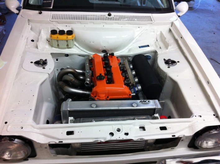

Theres a guy making duratec into escort conversion parts in australia as seen here > viewtopic.php?p=19320, no locally made zetec conversion bits as far as I know though.
I've been looking at this myself and the duratec tends to be slightly more expensive however it seems to have a better potential, and i'm pretty sure you can get one in an escort (auto tunnel) without any modifications.

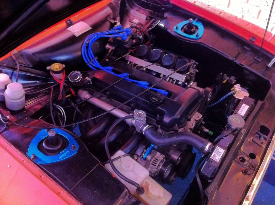

I cant speak for the Zetec, I have had virtually zero contact with that motor apart from seeing one first-hand in a Mk2 Van. I can speak for the Duratec as I have dropped one into a Mk1 in street form and hope to get it rego'd. I didn't have to choose between one or the other as my shell come with the Duratec.
I have a build thread over on the TS forum which covers most of the questions you asked (not really a build thread, but just covers putting the engine in).
As mentioned, Eurospeed in Queensland has most all the parts, and I have heard Mr Roger Carroll has been very helpful with another Perthite looking to do this conversion.
In a short answer to your list of questions, my '73 manual Mk1 required no major structural changes. A different gearbox mount to suit the T9 (including removing the old gearbox mounting points), and a Worldcup cross-member which is a bolt-in job. Costs start to mount dramatically when the need for aftermarket induction, bellhousings to match mazda to ford bolt patterns are taken into account. The Zetec conversion would be cheaper TTBOMK.

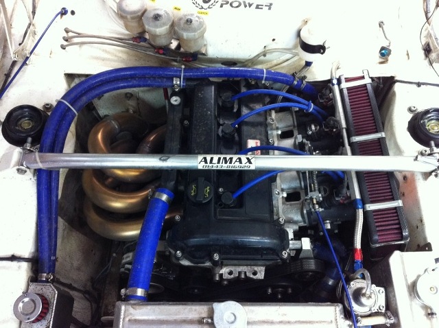

my 2 cents I prefer the zetec blacktop over the silvertop. Heaps of off the shelf performance parts in the USA. Specifically turbo parts. Sierra type 9 bolts up, admittedly minus 1 mount lug. Minor mods to flywheel required to run the pinto clutch which IS up to the job for N/A applications. It has the same style engine orientation/design as the BDA (asthetically pleasing) Retro ford are developing BDA copy cam covers. too. The ST170 zetec variant is a cracker if you can find one. (Cosworth involved in development) Very cheap to buy the blacktop motors. Lots of UK parts too. Escort ho manifolds. I realised 146 rwhp running carbs from a stock ST170 in a MK 2 Escort. (not rego'd) Expect about 110 rwhp out of a std blacktop on carbs. Apparently able to rego in NSW upto 2.1 turbo.(last check early this year new rules coming) Sure the duratec is ALL alloy and bigger and better and stuff. BUT, For me the zetec just looks right. GO the ZETA!

You can't beat the look of the Zetec with the cam gears, exposed belt, just like the old BDA. Add a replica cover, 45's and a raceline manifold. It looks period, when done properly. As close as most will get to owing a BDA escort. Duratec won't ever be in the same league being chain drive.
